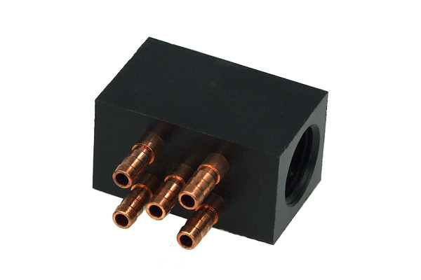

I bought a few MCX One's
and the breakoutboxes for 5 concurrent cooling boards,but on a normal pump.
