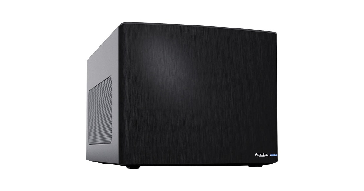

                        I would just backup via the network to another computer.
                        Biggest problem is the space for the case: it is high and difficult to reach. So I don't want a heavy case that would be difficult to put there and work on when standing on a ladder. Taking it down would require disconnecting it, and if the case is too big there is not enough maneuvering space. A light, small case could be taken down more easily if needed. I know this won't happen that often, but changing disks or even just cleaning the ventilators etc. should be possible.
                        As I don't need to recycle old hardware, and there are interesting mini-itx mainboards, these may be interesting:
                        Computers, gaming, multimedia en huishoudelijke elektronica van topmerken koop je voordelig bij alternate.nl. Voor 22.00 uur besteld, de volgende werkdag in huis.
                        De zwarte Node 304 van Fractal Design is een desktop behuizing met plaats voor een ATX voeding. De behuizing beschikt over zes interne 3,5"/2,5" in...
                        or some of the even cheaper cfi models I posted earlier, if I could find them.

                                Possibly interesting case:
                                You can add drive cages. nothing hotswap, but the general format of the case would make it well suited for my application: it is low and deep, and you can quite easily access it from the side.
