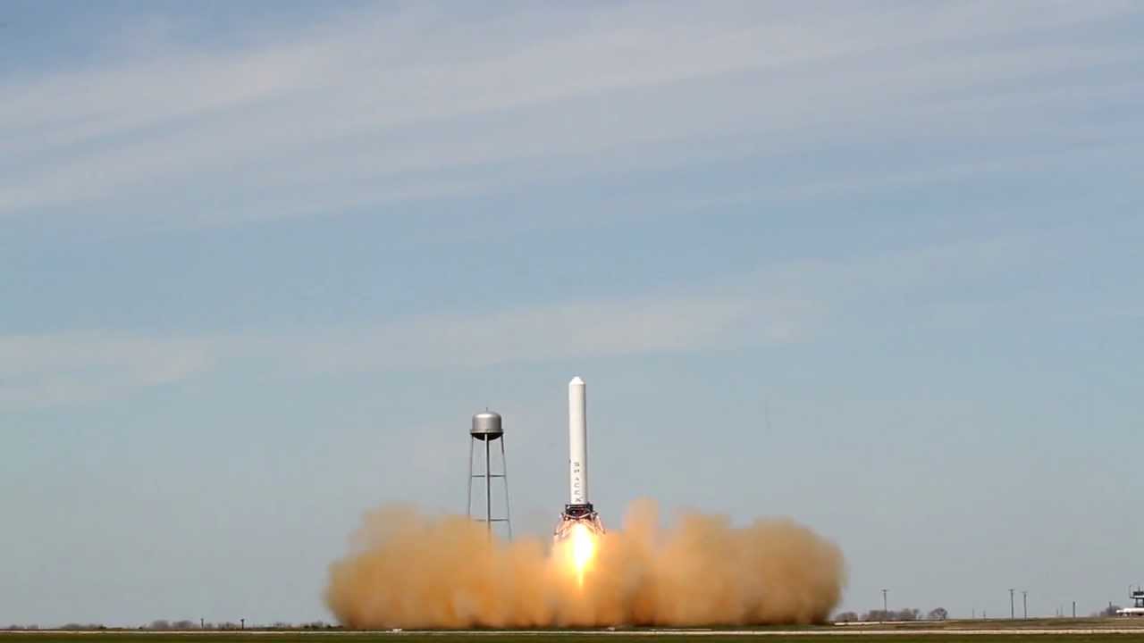

                        Video from the March 80m "HoverSlam" flight, which showed the Gr****opper landing with a thrist-to-weight ratio of >1. It does this by timing fuel consumption, descent & throttling so that its vertical velocity zeros out just as altitude = 0m. Before the now lighter Gr****opper can rise again, it cuts its engines to settle. Neat.
                        The passenger is a cowboy mannequin dressed up as Johnny Cash.

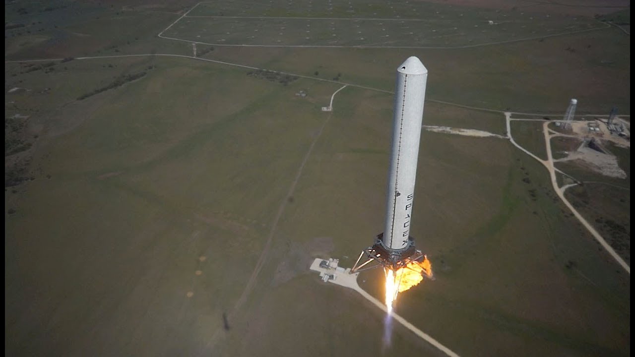

                          SpaceX Gr****opper flies again yesterday. Yes, the cowboy mannequin in Johnny Cash gear went for another ride. Last hop was 80m, and before that 40m, so they're doubling to tripling the previous efforts.
                          "SpaceX's Gr****opper flies 820 feet, tripling its March 7th leap. Gr****opper is a 10-story Vertical Takeoff Vertical Landing (VTVL) vehicle that SpaceX has designed to test the technologies needed to return a rocket back to Earth intact. While most rockets are designed to burn up in the atmosphere during reentry, SpaceX's rockets are being designed to return to the launch pad for a vertical landing."
                          [Musk:] Gr****opper rocket flies up 250m, holds against wind and lands. Vid taken from our hexacopter
                          [Question:] Was the rocket leaning into the wind while it was holding it's altitude?
                          [Musk:] yes
                          [Question:] is the rocket evolving each trial or are you just testing what is capable of?
                          [Musk:] evolving
