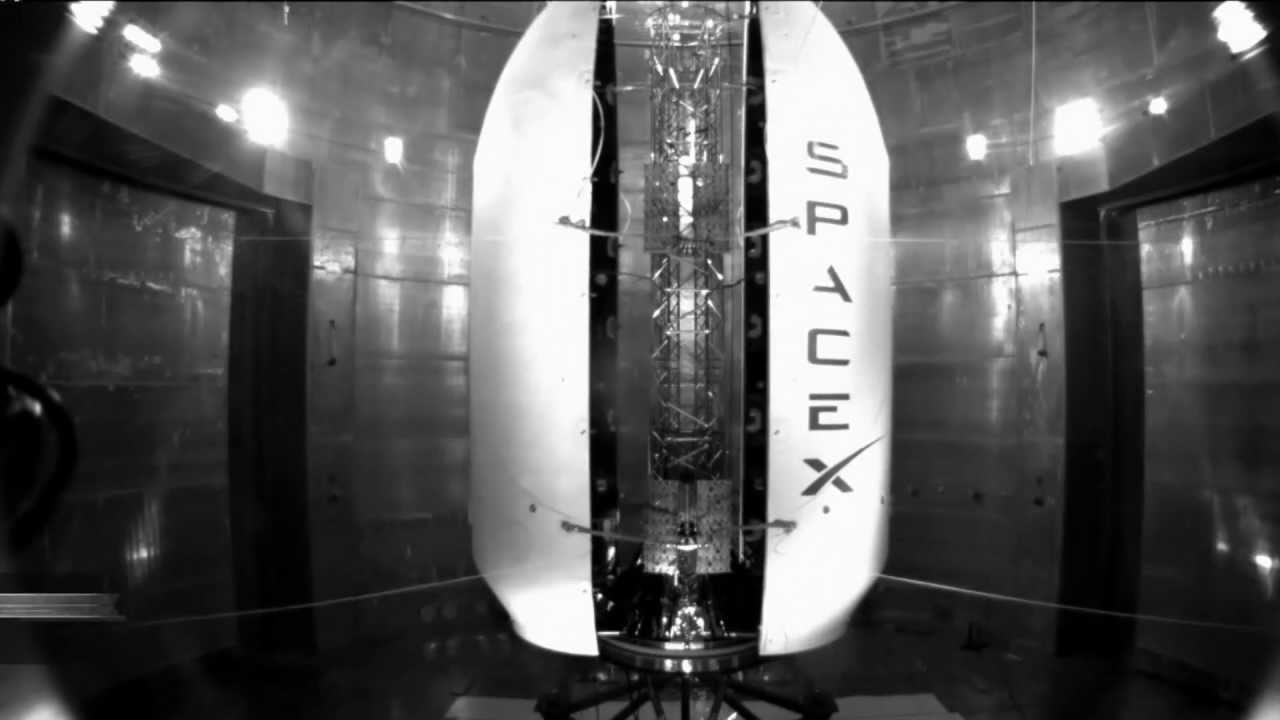

    Standard 5.2 x 13.9 meter payload fairing (PLF) for Falcon 9 v1.1 and Falcon Heavy. Getting ready for the June 18th maiden flight of F9 v1.1

    Rocket fairing almost ready for deployment test in vacuum chamber. Man lift on right for scale pic.twitter.com/BLOTThWFvw
      Re: Falcon 9 v1.1 maiden flight
      • cargo fairing test in the huge NASA Plum Brook vacuum chamber was successful.
      BTW: that fairing in the pic? A city bus could fit inside it, and there's talk of an even larger one.

            Here's a video of the Falcon 9 / Falcon Heavy 5.2m fairing test done at NASA Glenn's Plum Brook Station vacuum chamber -
