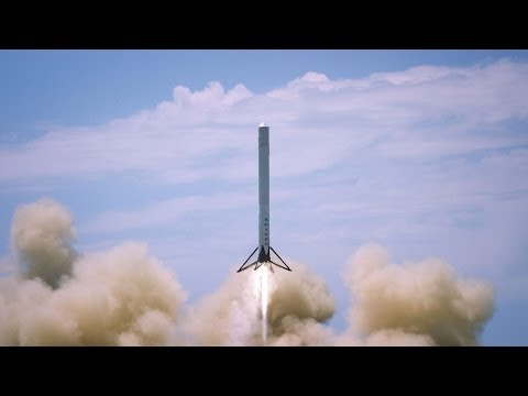

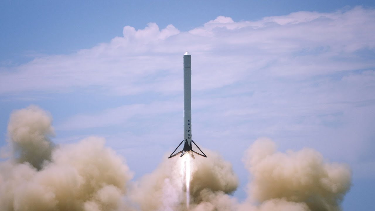

SpaceX F9 1 Dev-1 reusable testbed (1000m, smooth as silk)

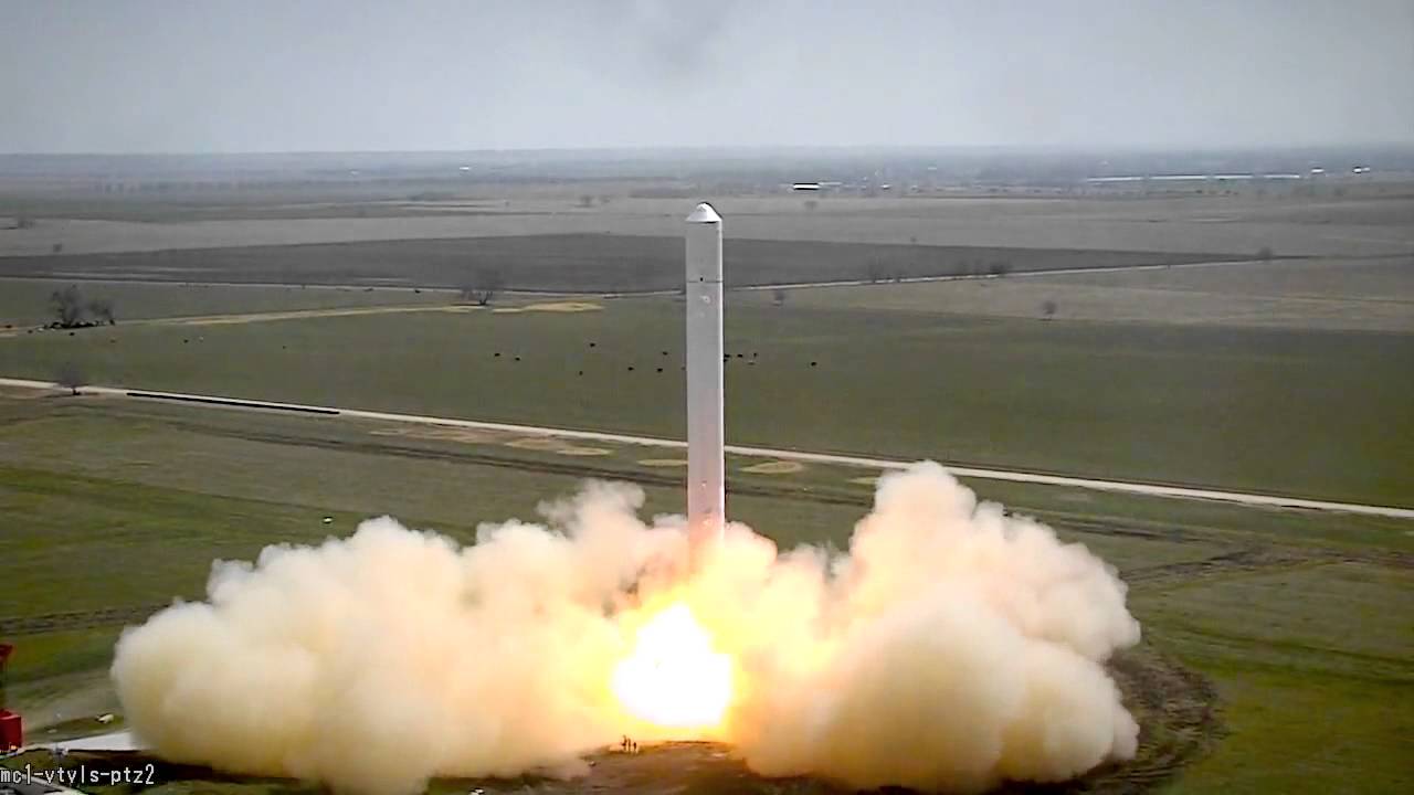

          F9R Dev-1 FLIES!!
          Which means it must have landed on those previously untested legs.
          We should get a video soon.
          Gr****opper's successor flies at SpaceX's McGregor site
          Reports have been confirmed that SpaceX's Falcon 9-R development vehicle made its first free flight today at McGregor taking off, hovering, moving sideways and landing. I've seen video of it (though it turns out that video wasn't supposed to be made public yet and is no longer available).

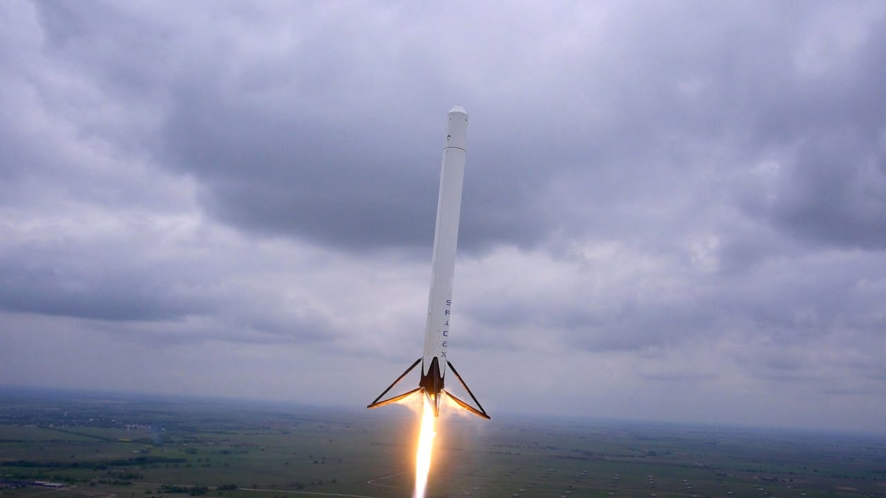

            SHE RISES!!
            Yes the legs get toasty, but they're coated with a thermal protection material like what Dragon wears. They won't see this much heat in real launches as they deploy late.

                  1,000 meters, 4x as high as last time. Dev-1 is a sporty lady
