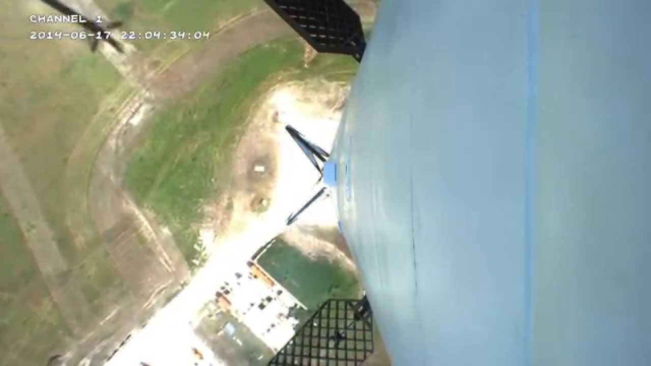

    Normal F9R Dev-1 flight testing grid fin guidance.
