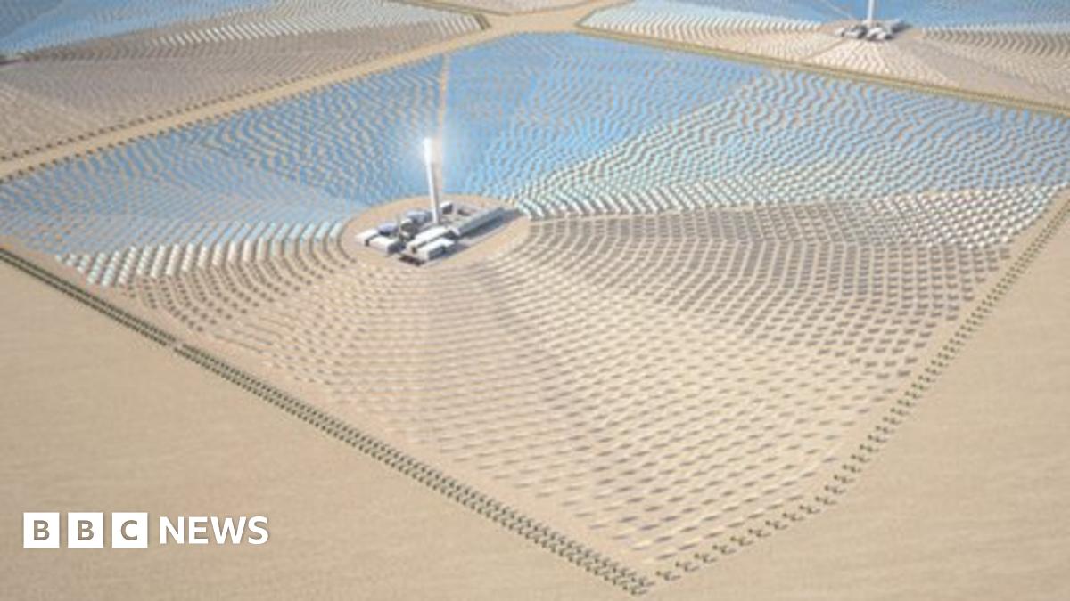

    Latest proposal for CSP
    Investors are seeking funding from the UK government for an ambitious plan to import solar energy generated in North Africa.
    This looks like a very interesting proposal which could be implemented very quickly. However, 2 GW is not an enormous quantity of electricity, roughly equivalent to 2 large thermal or nuclear power stations.
  • Jammrock
    The Berserker
    • 8661
    The Sahara dessert is a great place to produce engery. Not a lot of wild animals to harm (except some bird migrations, but I don't know if they pass through that part of Tunisia), no civilization to bump up against, and lots and lots of sunshine year round.
    I think renewable energy will be North Africa's major export within 20 years. 2GW is a good start. If it works well it will be 10GW-20GW in no time.

        The proposed CSP station is in the middle of the Tunisian desert away from any migration route (actually a relic of the now-defunct Desertec project, which had already taken this into account.)
