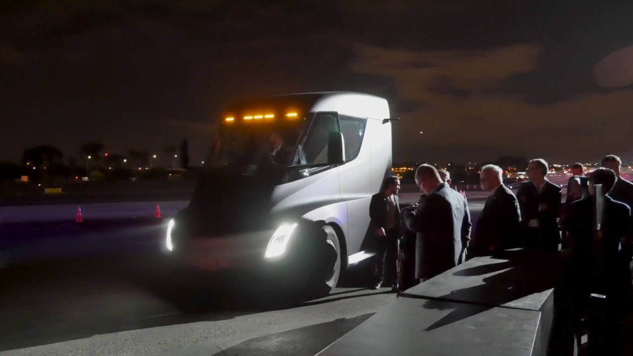

          A little from the Semi (and new Roadster) introduction tonight,
          Tesla Semi
          4 motors
          0-60 in 5 seconds, 0-60 in 20s with an 80klb load (36.287 tonnes)
          Super aerodynamic
          Up to 500 mile range
          Center-seated driver
          Cab interior 6' 6" high (1.981m)
          Comes in space gray
          $5000 for a reservation
          Production in 2019

              I'm a bit puzzled why they claim center seating position is better for visibility. The roads are not symmetrical, and for example when seated on the left you have a better angle to see what is in a sidestreet to your right. Of course, such trucks will most likely drive mainly on big roads where that type of visibility is less of an issue.
              I also wonder if it meets the restrictions for Europe. Here, almost all trucks are cab-over, as there is a limit on the maximum length of the truck. This seems to be a longer construction than a standard cab-over, but it may be an illusion. (the trailer seems to be closer)
                There are center-driver vehicles, not the least of which are open-wheel racing cars and 3 seater McLaren F1.
                One aspect of visibility that people don't pay much attention to is the windshield post at your 10 or 2 O'Clock viewing position. Being in the center, and was a wrap around windshield, those posts will be further from the center of your visual field.
                Another advantage for Semi or other commercial vehicles would be no need to make two versions, one for left-hand-drive and one for right-hand-drive countries. One and done.
                  Yeah, but race tracks are symmetrical (no right/left lane) and no need to give way from the right or so.
                  Still, the A-pillar visibility is a good argument. And the side windows look low enough to make sure there is no bigger dead spot below them. The screens look a bit like they may cause a blind spot front-left and front-right (where a pedestrian could be unseen), but that maybe due to the way the photos are made.
