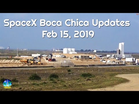

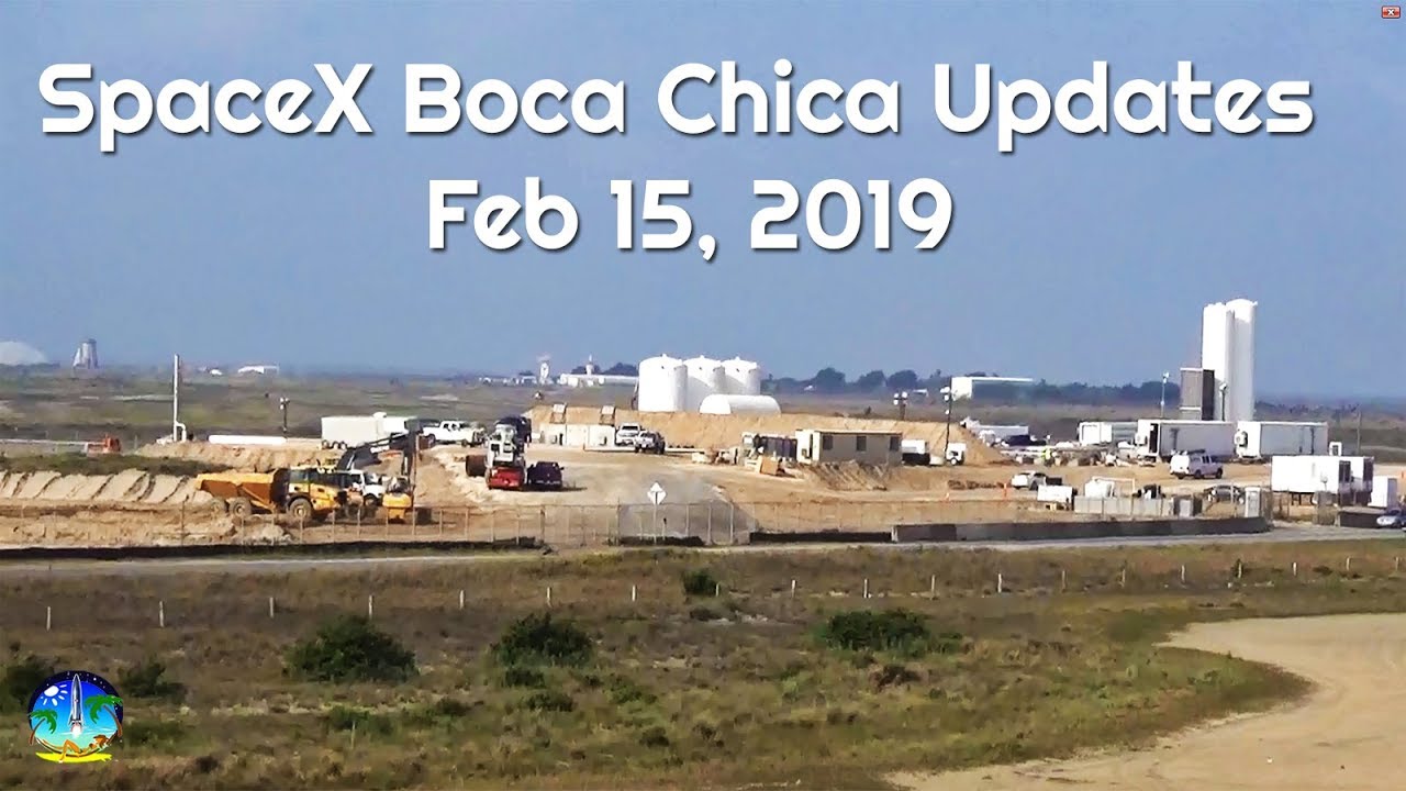

                              Video of the Boca Chica TX facility construction
