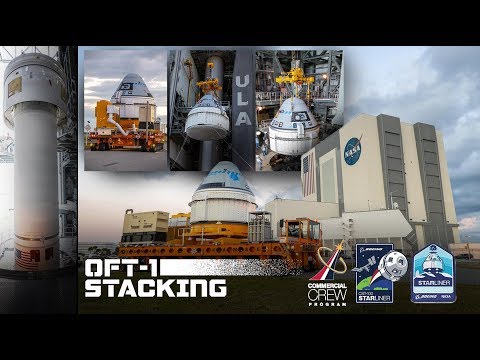

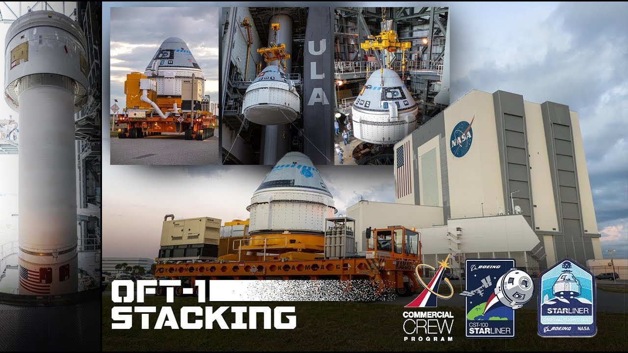

    Roll-out and integration
    The cylindrical skirt below the spacecraft's service module is intended to protect the soda-can thin Centaur upper stage tanks from being crushed by hypersonic shockwaves, something discovered in the wind tunnel. Boeing did paper milestones first, waiting to cut, bend & test metal.
    The 13,000 kg Starliner will be the heaviest payload ever orbited by Atlas V, the previous record being a 7,492 kg Cygnus cargo vehicle.
