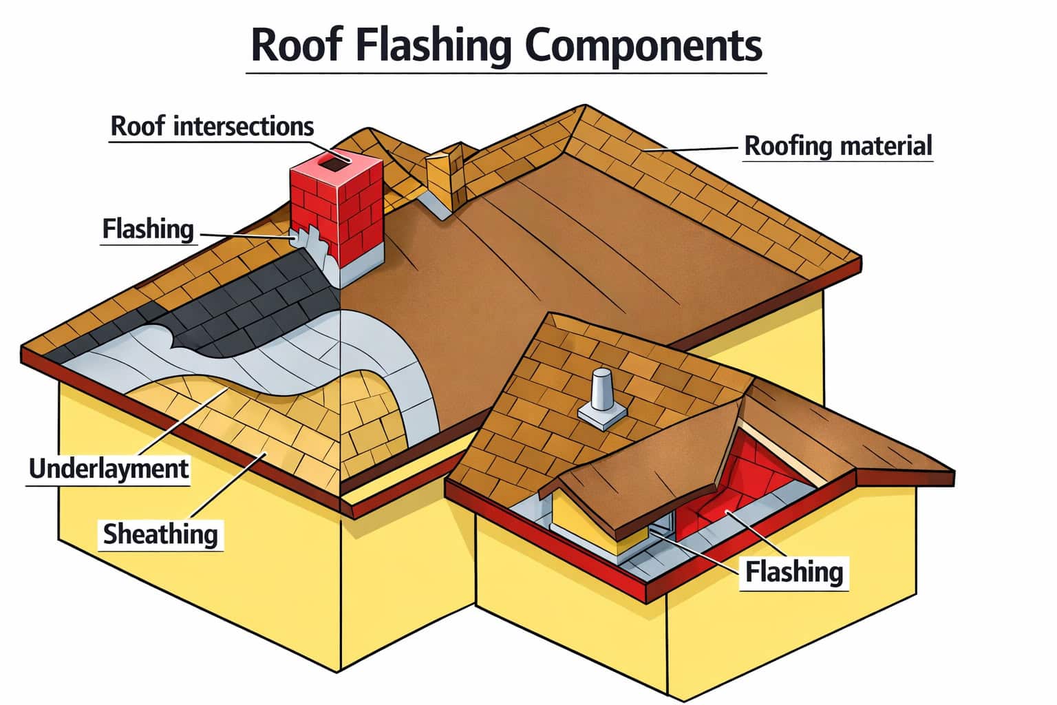

      You can use aluminum or galvanized steel, but IMO you're better off spending the extra for stainless steel or copper if you plan on staying in the house or the environment is harsh as they'll last the longest.
      The layering goes; waterproof membrane, roofers felt, flashing then shingles with lots of roofing sealer where appropriate, meaning the metal to metal joints.
      With step flashing the procedure varies according to how the vertical wall is finished. If possible the flashing should be slid under the existing siding on the vertical wall.
      The leading comprehensive guide on roof flashing done right from the home improvement and roofing experts.
      Brick is of course a different story. Ideally with brick there should be a cap flash going into the mortar joints then folded down over the top of the vertical flashing, but this is only easy with new construction. Otherwise get ready to chisel/grind out the old mortar then replace it after shoving in the flashing...which hopefully you have already bent
      This procedure is very much like flashing a chimney, so take your cues from that if you have one. Here's how to do a chimney;
      If you're not up to that then glop on the sealer and hope for the best.
