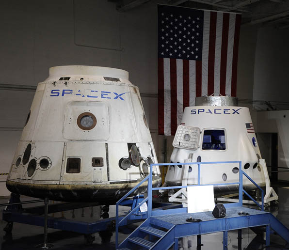

Dragon will be available with 2 sizes of cargo trunk; the existing 2.3 meter long version and a 4.3 meter long version for larger unpressurized cargo.

SpaceFlight Services will also handle payloads for the DragonLab free-flying experiment platform - an uncrewed robotic Dragon capable of 2 year science etc. missions. This will open up long term ISS-style microgravity research to universities, companies & governments who can't get ISS time.
