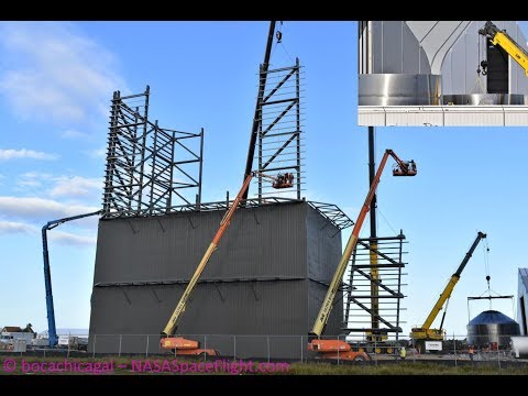

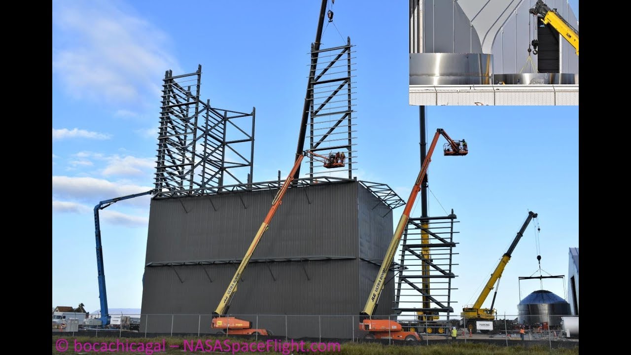

The new High Bay structure for stacking Starships is almost complete. They'll build the cargo bay/habitat section, propellant tanks, and the thrust module and assemble them in there.
Starship SN-01 should be going to the pad for tests & a static fire by early March - soon after stacking in the new High Bay. If all goes well, a flight test a few weeks later.
Starship SN-02 is hot on its heels, with components being built, rings & domes stacked, with vehicle stacking after SN-01 vacates the High Bay.
They want to scale production to 2 Starships a week in order to populate the operational fleet.
Yes, a fleet.

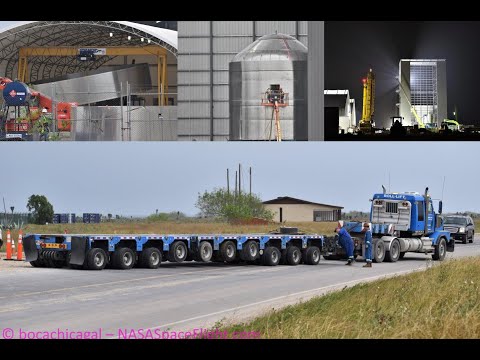

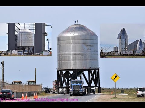

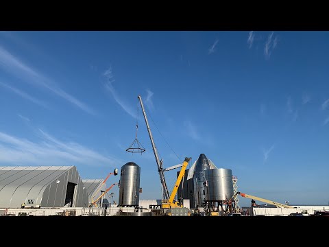

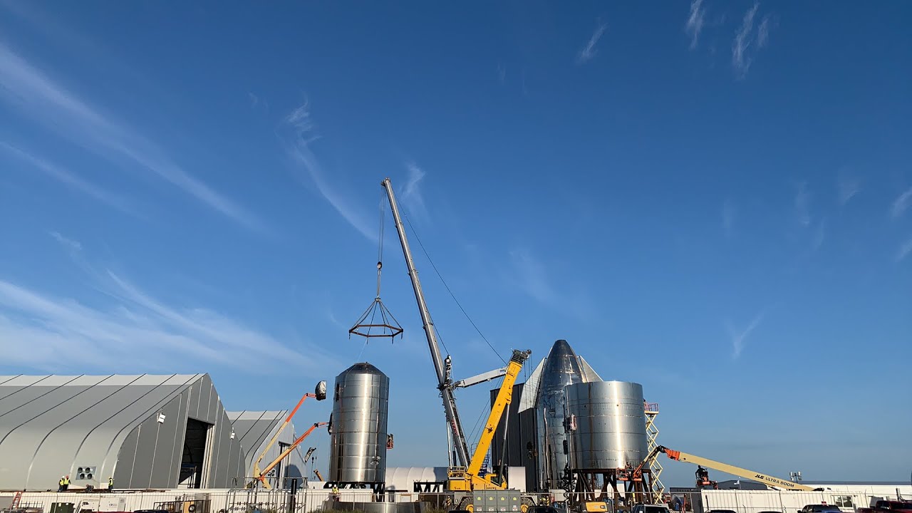

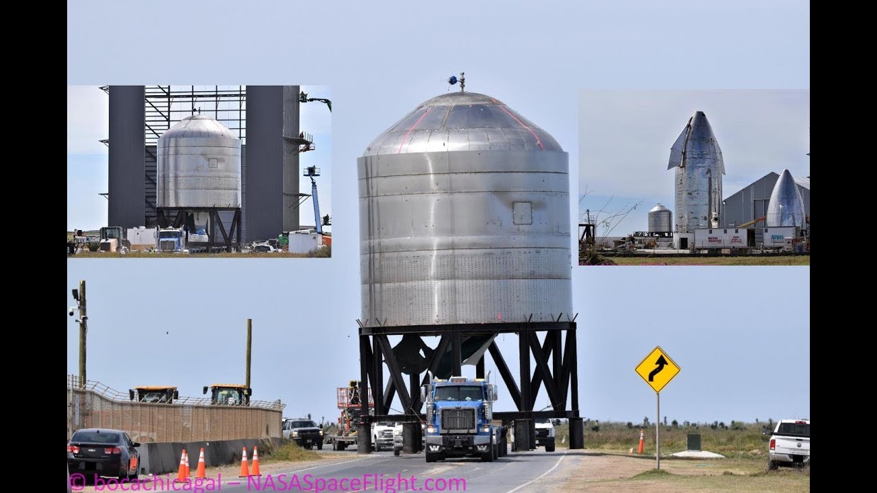

Starship SN-01 stacking, tests, outfitting (LabPadre stream screenshot)

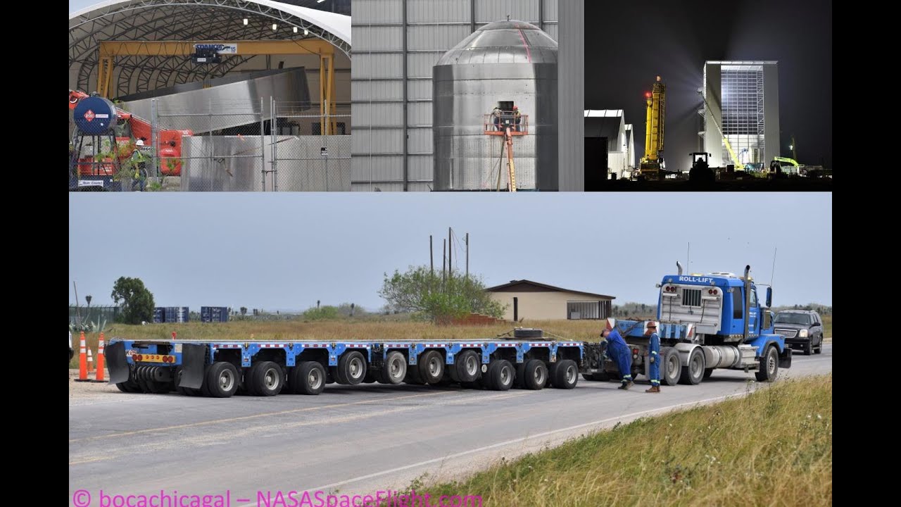

Cargo module sections are still indoors.
Stacking
LabPadre livestream
SN-01's propulsion module is at the pad for cryotreating & tests. A few weeks after a good static fire, the 20km test flight.
Getting the crane & load spreader ready to place it on the test pad.
The cargo module/nose cone is being stacked.
SPadre @SpacePadreIsle
She pulled a fast one on everyone with a stealth mode rollout this morning but there she is, proud and tall, waiting to secure her place in space history! #SpaceX #Starship #BocaChica https://t.co/6kuosPj0Al
https://twitter.com/SpacePadreIsle/s...21426818027521Dr. Mordrid
