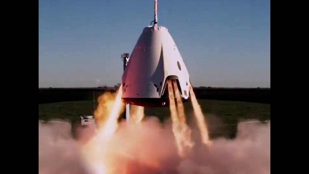

    Crew Dragon SuperDraco escape engine tests, each of the eight engines producing 71,000 newtons (16,000 lbf) of thrust.
    In the last sequence the engine is being rapidly throttled, which allows thrust differential steering.
