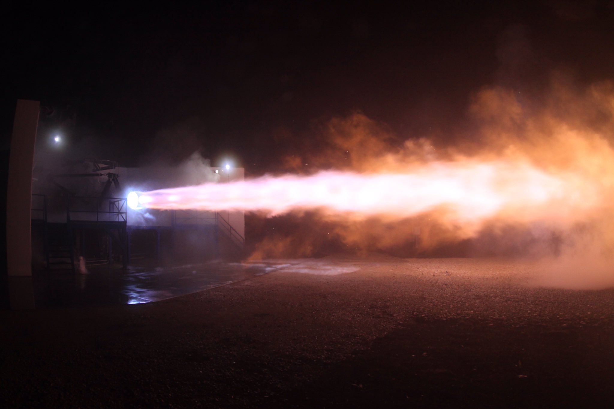

    YAY!!!! An engine designed for human interplanetary travel.
    Propellants: liquid methane and superchilled liquid oxygen (66° Kelvin)
    @elonmusk
    SpaceX Propulsion just achieved first firing of the Raptor Interplanetary Transport Engine https://t.co/vRleyJvBkx
    @elonmusk
    Production Raptor goal is specific impulse of 382 seconds and thrust of 3 MN (~310 metric tons) at 300 bar
    (note: 310t = 694,400 lbf)
    Mach diamonds
