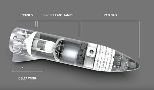

                          At IAC 2017 the BFR Booster (aka BFB) and BFR Spaceship (aka BFS) were rescoped to a 9 meter diameter with 31 sea level Raptor engines in BFB and a mix of 4 vacuum and 3 sea level Raptors on BFS.
                          The USAF vacuum Raptor is due for delivery to the Air Force in December, and tests have been ongoing at the McGregor test center since September 2016.
                          The vehicle redesign keeps a 150 tonne to LEO lift, up to 100 passengers in the BFS, and the ability to be reconfigured as a propellant Tanker or Cargo ship.
                          It's also configured to be a satellite deployer to replace both Falcon 9 and Falcon Heavy, and for Point-2-Point human and cargo intercontinental transportation. FAA and DoT are exploring what regulatory frameworks will be needed.
